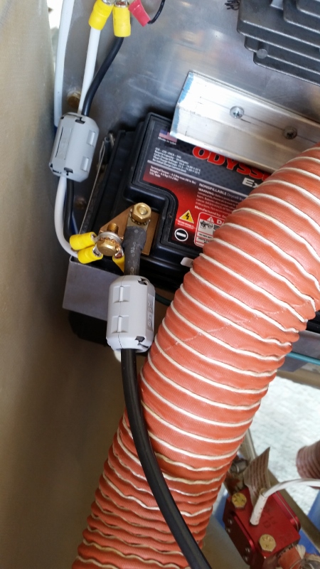

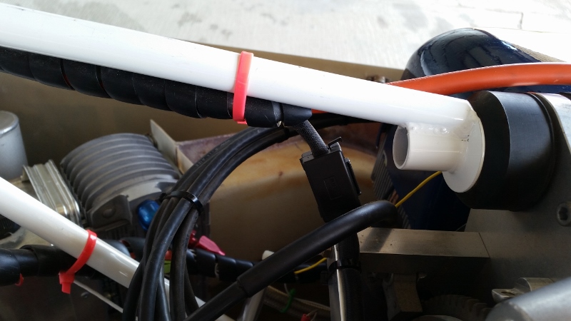

Well this has been a real challenge, but it now works correctly! I woke up one night and and realized that if it only failed in the air it must be something with the alternator. The Jabiru charges mainly at higher rpm. I applied ferrites to the cable from the alternator and the ground cables at the battery. Evidently the alternator on the Jabiru 3300 contains some spurious frequencies in its output. I flew for 2 hours yesterday with no disengagements from the AP.
- grounds.jpg (229.2 KiB) Viewed 30204 times
- Alt.jpg (175.89 KiB) Viewed 30204 times
