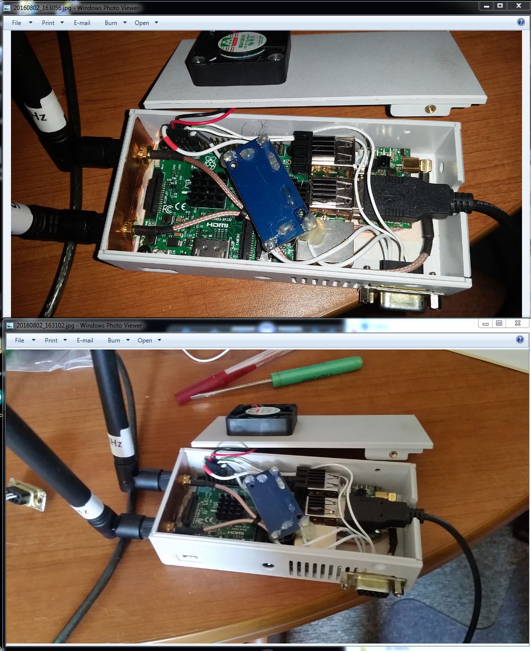

I did mine a little different. I didn't like having a micro usb cable plugged into the side without it being secured to the PI. Plus having a USB-Serial cable seems to disable the USB GPS for now (with current code V1.0r1)
The GPIO serial data & power go to a DB9 connector. The blue board in the middle is just a LM2596 DC-DC Buck Converter, so I can feed the unit battery power and it steps it down to 5volts.
The serial data coming out of the stratux is TTL levels, so using the USB to TTL-UART cable mentioned above will go into the back of HXr.

MolsonB wrote:The GPIO serial data & power go to a DB9 connector. The blue board in the middle is just a LM2596 DC-DC Buck Converter, so I can feed the unit battery power and it steps it down to 5volts.
