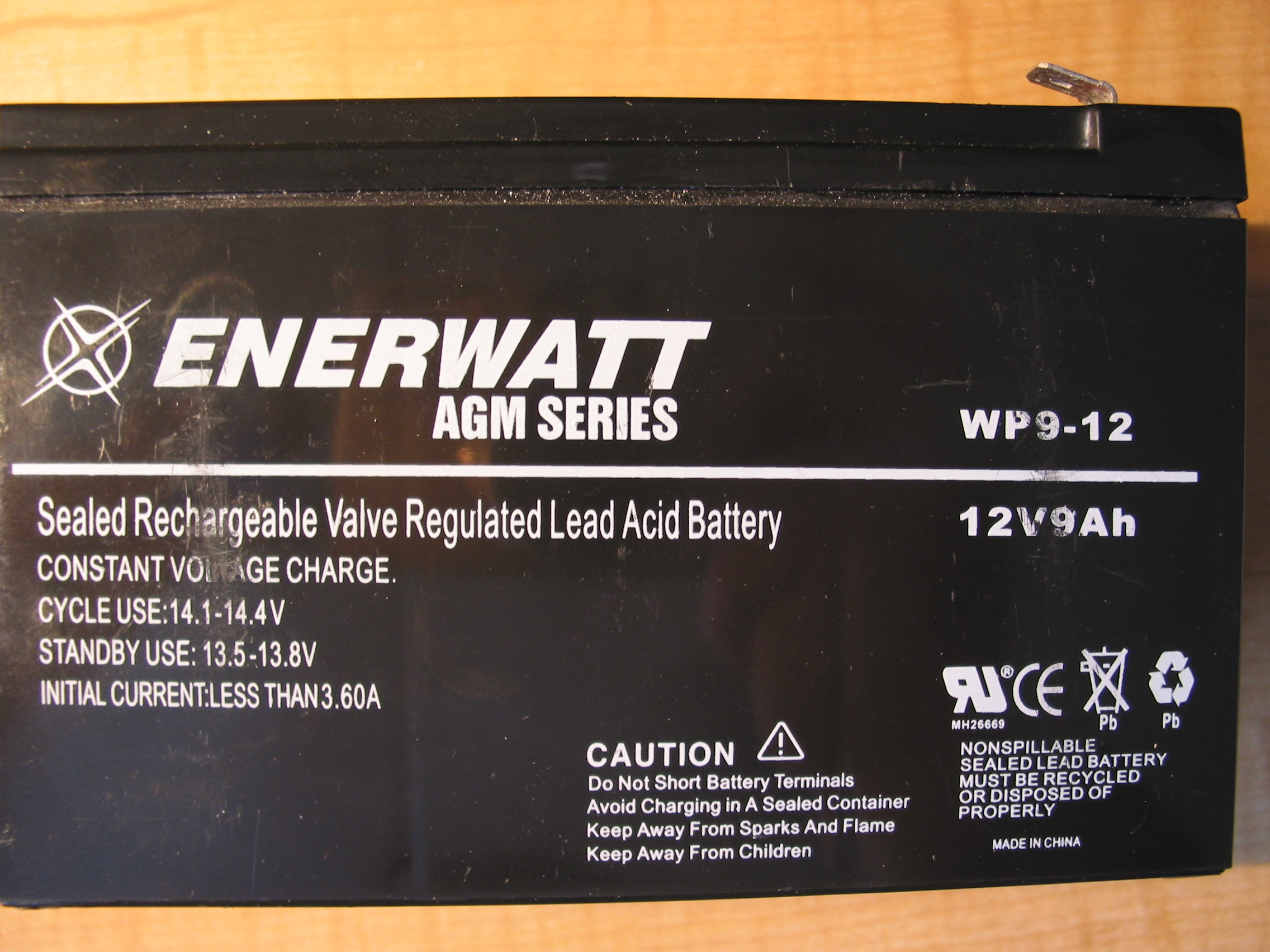

The BU battery is an ENERWATT AGM WP912 12V9AH. Picture attached. Appropriate capacity? I'm not clear what INITIAL CURRENT:LESS THAN 3.60A means.

'Initial current' is related to the previous 3 lines; how to charge the battery. If it's in 'cycle use', charge at 14.1-14.4 V. If it's in something like an emergency light in a building, with a charger on it constantly except when power fails, the charger should be at 13.5-13.8 V (a 'maintainer' voltage). And in any case, the initial charge *current* shouldn't exceed 3.60 Amps, to avoid damaging the battery. In other words, don't let it get to a discharged state, and then crank your engine where the alternator could push 10-15 amps at it due to its discharged state.
To your reboot issue: Can you share how you have the backup wired into the system? If it's simply tied into the main battery feed, then the starter will pull both batteries down during start. If it's wired to the extra diode-isolated inputs on the EFIS-s, and the battery is good, you shouldn't see the rebooting.
