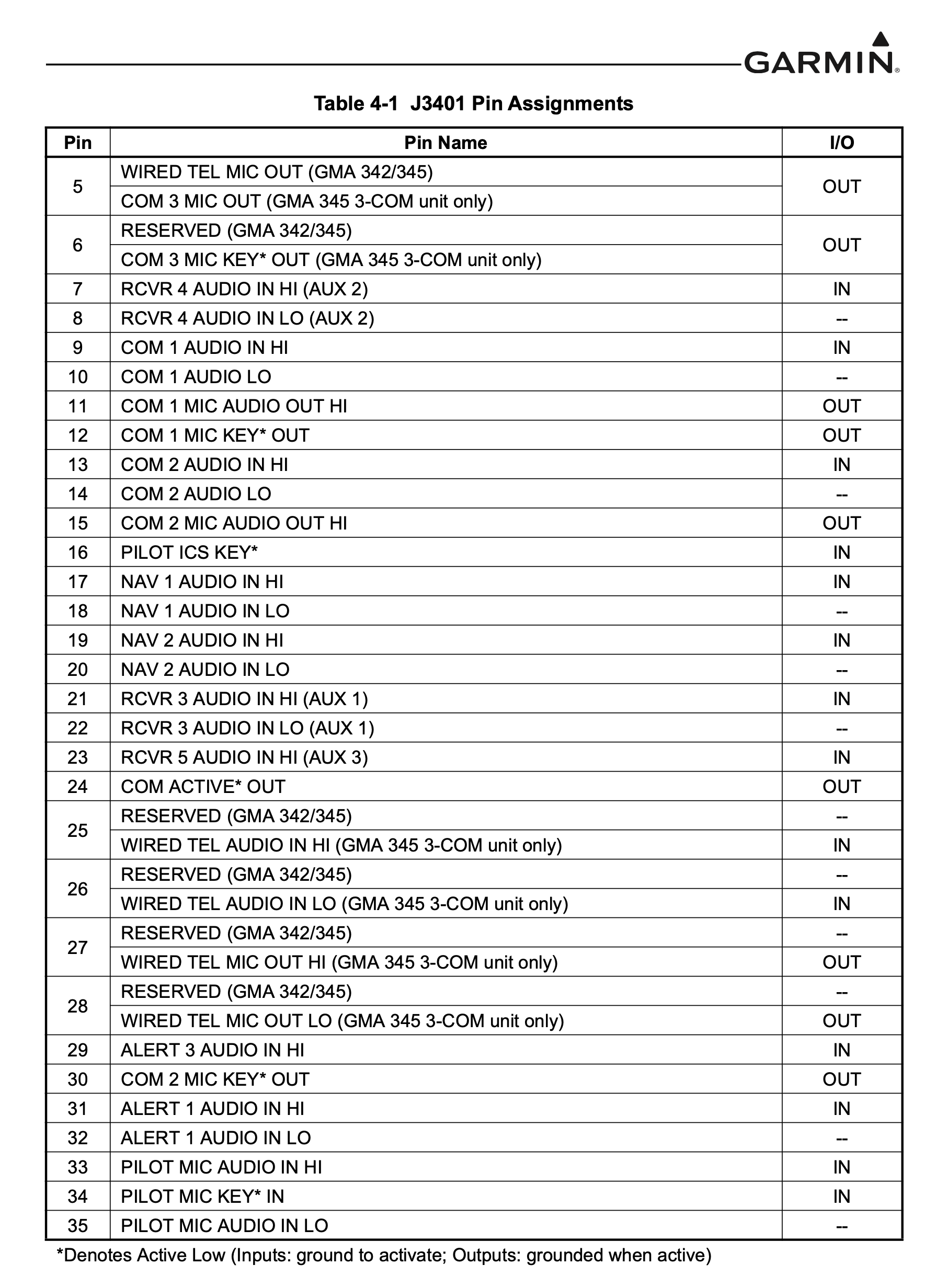

Hi Jeff, thanks for the info... to clarify;
My NAV's are all used, however what appears to be AUX2's are available (*IF* these are the ones you are referring to).
When you say I have to "keep it on to hear it" are you simply saying the Audio Panel has to be powered on (if yes, then understood).
So, see attached Pinout... my Pins 7 and 8 are available... would these work per your reply or am I missing the boat (plane) on this one?

I mean they are switched inputs controlled by a button on the panel so you have to make sure the input is turned on with the button, and some of those inputs may be temporarily muted by other audio. Looks like pins 7 and 8 should work for Aux2.
