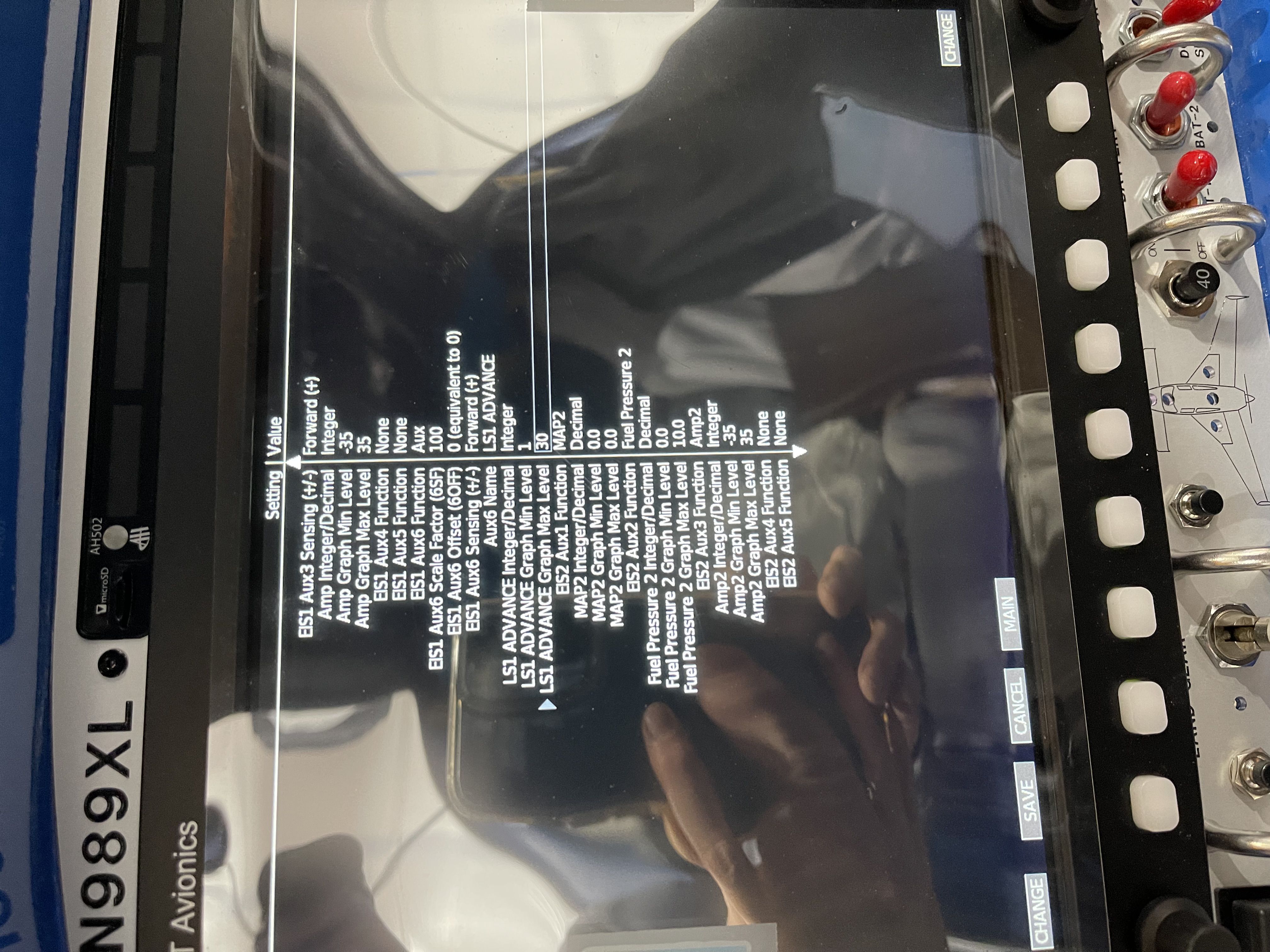

Good Day Jeff,
I wired the outputs (per the diagrams) and as it relates to wiring to the HXr or the EIS AUX Inputs I chose to wire it from the L2e Dongle directly to the EIS (Pins 16 and 17) and not to the EFIS.

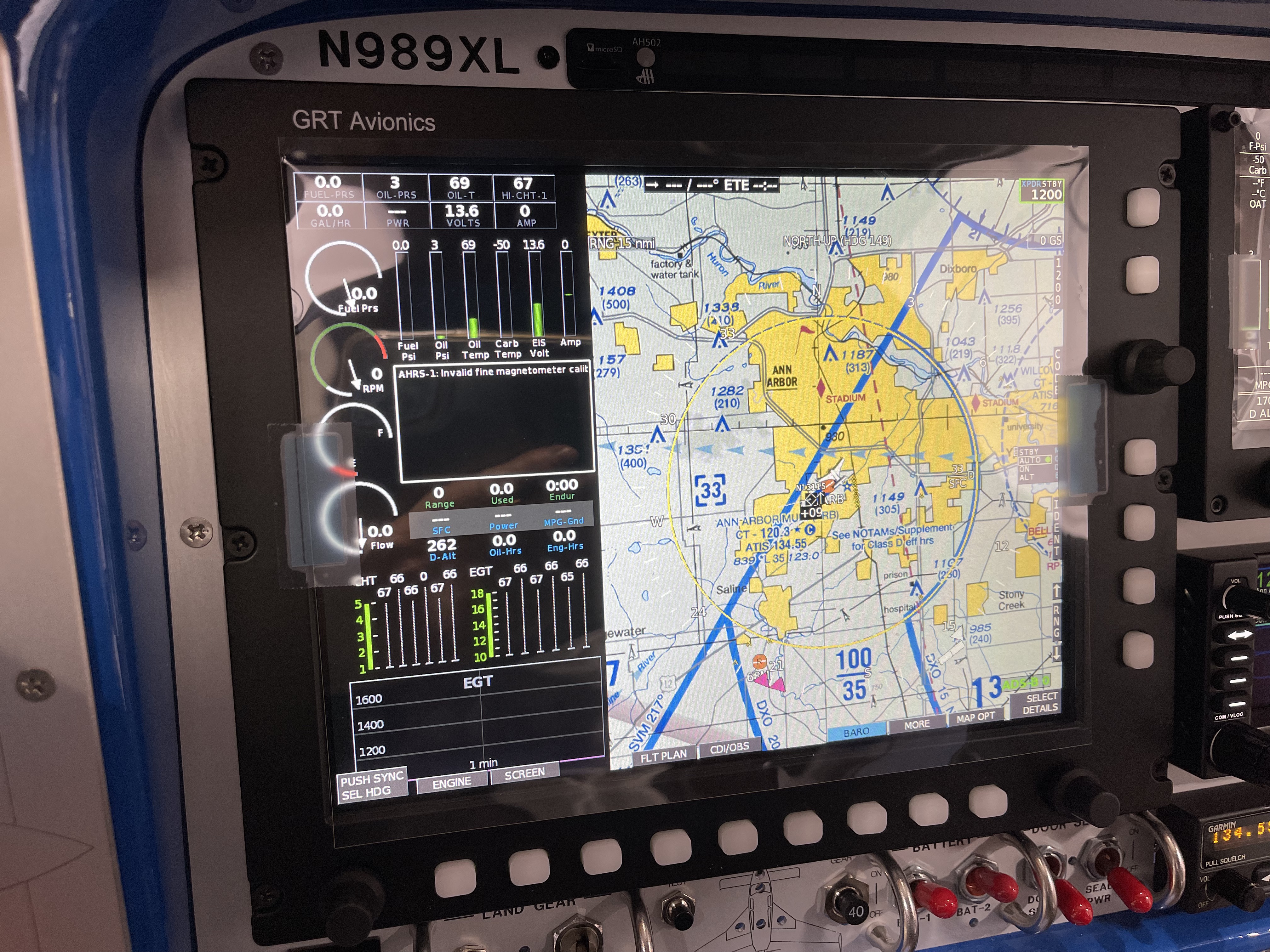

I see the instructions below were for the HXr instead of the EIS, however thought I was making progress but seem to be missing something (can you please see my photos below and let me know where I am going wrong)?
Since Pins 16 and 17 represent AUX6 and AUX5 respectively I started with AUX6 (I have not entered the AUX5 yet due to this and that is why you will see it is showing "none")
I then renamed to "LSE ADVANCE") and saved but did not see anything after saving and then got completely confused on setting the graphics bar or otherwise.
Hoping you can help,
Gary Ernest

You need to set the EIS1 Aux6 Scale Factor to 25 for the integer mode (no decimal place).
The EFIS doesn't automatically assign the input to any bar graphs or data boxes for you. You have to decide where and how you want to display the advance (dial, bar graph, data box) and then configure one of those to show your new "LS1 ADVANCE" input. The Graphical Engine Display settings page has settings for all of the dials, bar graphs (A1-A6, B1-B6, and combo inset), and data boxes (the main ones in the upper left are Box 1-8).
