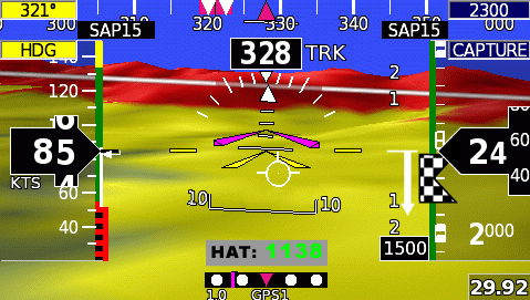

1) More significant selected target altitude symbol:
Right now the small magenta altitude target that slides up and down the altitude tape is hard to see and forces the user to waste valuable scan time to compare numbers to judge altitude compliance. I suggest making the altitude target a large checkerboard matching "puzzle piece" all the user has to do is think of the black altitude block as an airplane nose and fly it up or down into the checkerboard. Push the black airplane nose down onto the target or pull the black airplane nose up into the checkerboard target, easy to do and requires no number reading. A quick glance at the screen will instantly show if high or low from target altitude.
You'll also see that I changed the VSI display to a simple arrow that grows as needed up or down from the aircraft reference altitude line. It doesn't have to be exact since the exact number is shown numerically in a black box that the arrow points towards

The Synthetic AP approach (SAP) HITS is great for situational awareness. However, the green and red Height Above Touchdown (HAT) numbers are hard to see in the ground clutter, so I suggest putting them in a gray box a with a label.
