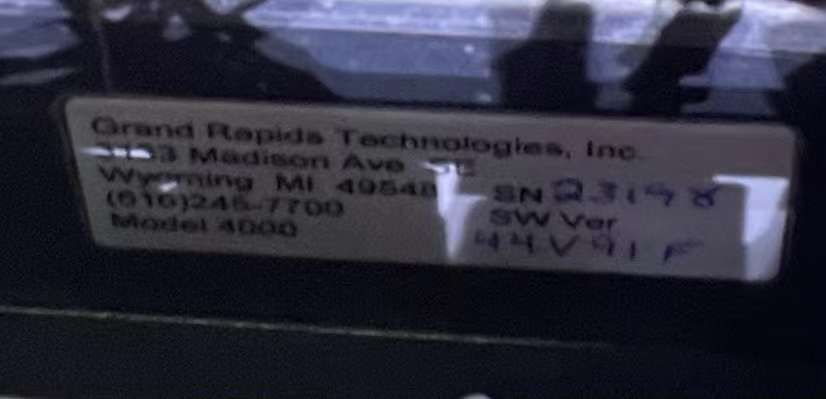

The new to me plane has an EIS 4000 that always reads 0 fuel flow, when I bought the plane both the seller and I just assumed there is no sensor installed. Then I talked to the owene before this seller and he swore there is a red tube installed, which I probably didn't even look for.
So now I am trying to figure out if the 0 reading is because of fuel flow option is disable before I take the cowling off to troubleshoot, per the manual I did first step change FloScan to 83, didn't make any difference. I do see some random numbers in the FC1 and FC2 field, not sure who entered them.

A "Red Cube" is a common fuel flow sensor used with the EIS. If the EIS was ordered with the fuel flow option preinstalled then it will have an "F" at the end of the "SW Ver" on the sticker on the bottom of the unit and that F would mean fuel flow is always enabled. If it doesn't have an F, then the FC1 and FC2 numbers may indicate the option was added later. You can e-mail support@grtavionics.com with the model and serial number (SN on the sticker) to see if it is on record and what the correct FC1/FC2 numbers should be.

I am pretty sure the red tube and the EIS were installed at different time, I'll go check the sticker for its version.

Looks like my unit does have fuel flow enabled, SW is 44V91F, SN is 23198. I guess the next step is to take the cowl off and follow trouble shoot guide?
