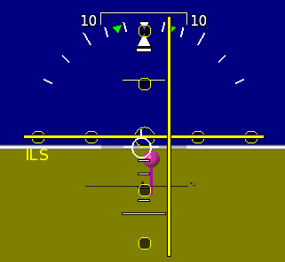

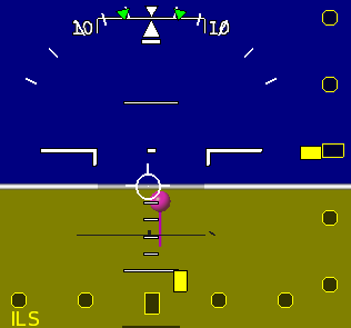

Since both ARINC and Analog inputs are from the GNS 480, they should both be set to NAV1. The EFIS will automatically use the NAV1 analog inputs if the NAV1 ARINC input fails. The analog inputs for "ILS Tuned", "VOR/ILS Deviations", and "GPS Deviations" will override the ARINC data even if they aren't connected. If those Analog Functions are turned on and you don't have the wires connected, turn them off.
If the EFIS is configured to follow the 480, make sure the mode displayed on the EFIS changes when you change the 480's mode with the CDI button. The text by the needles/scales near the center of the PFD should say "ILS" when in ILS mode (the 480 is set to VOR/ILS mode and an ILS frequency is tuned).
You can confirm the ARINC VOR/ILS data is being received in SET MENU, Display Unit Maintenance, ARINC Status. The VOR/ILS Frequency line should show the frequency set on the 480. If it doesn't there's a communication or setting error. Make sure the rates match (Low/High) and the 480 is set to send VOR/ILS data on one of the ARINC channels.

Re: No Glideslope on ILS
The "ILS" would be just under the full left deviation mark. This indicates that the deviation data is coming from the ILS and not something else, such as GPS or VOR mode.
