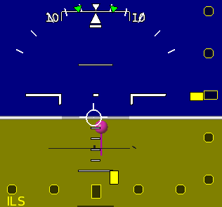

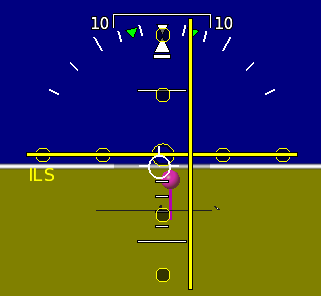

The "ILS" would be just under the full left deviation mark. This indicates that the deviation data is coming from the ILS and not something else, such as GPS or VOR mode.

If it still says GPS when the 480 is in LOC, then the EFIS is not programmed to follow the 480's mode. SET MENU, General Setup, "NAV Mode Source" should be External to automatically follow the 480's mode. If you don't want the EFIS to automatically follow the 480's mode, you must manually change the mode to NAV1 yourself to monitor the needles before capture. The ARM LOC or ILS will not change the mode until the capture occurs. You must also push EXECUTE in order for the capture to occur.
