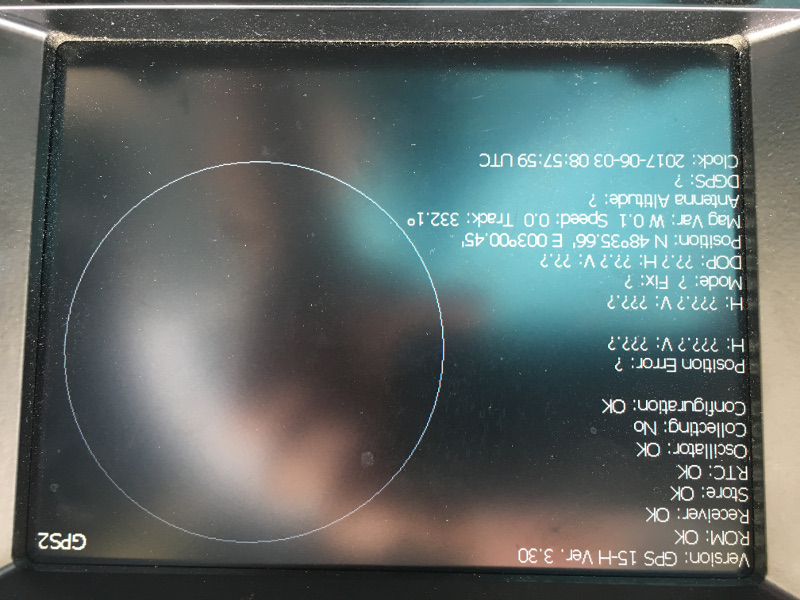

Hello,
Well, it worked with those settings for almost five years.
I already tried a few things :
- renaming to GPS 2, no change
- isolating the EFIS from the other : I sometimes get a fix, no satellites on the GPS display page and after a few seconds I get the error message.
- the serial counter is counting for some time, then it stops and there is the error message
See the picture taken during one of the tests.
http://www.notreavion.net/uploads/GPS1.jpg
I have ordered a Garmin GA25 antenna and will see if that can solve the problem, I will also do all further trouble shooting with only the EFIS with the internal GPS powered up to see if I find something.
Anyway, thanks for your input.

Posts: 880
Re: Internal GPS problem
A "No GPS# DATA FROM SERIAL #" alarm means the GPS stopped talking completely. This could mean someone accidentally wired something to Serial Port 3 Input pin 32 (RX3), which would interfere with the internal connection to the GPS. Your picture shows some data from the GPS, but the data is not complete (no satellite plot). A bad antenna would not cause communication errors, and should not cause a complete failure.
I don't understand why Garmin is selling the GA 25 now and not the GA 27. In the past they pulled the GA 25 because it had interference issues and told us to use the GA 27. Now it looks like they don't sell the GA 27 anymore. Hopefully they improved the GA 25.

Posts: 880
I'd want to test it with a simple power and ground cable (no other connections except the antenna). That is the first test we would do here to try to confirm the problem. If we can confirm the problem, then we would inspect the connectors and ribbon cables that connect the GPS to the main board. If we didn't find a problem there, we would try replacing the GPS. Last I checked, a GPS repair that required replacement was around $150.
