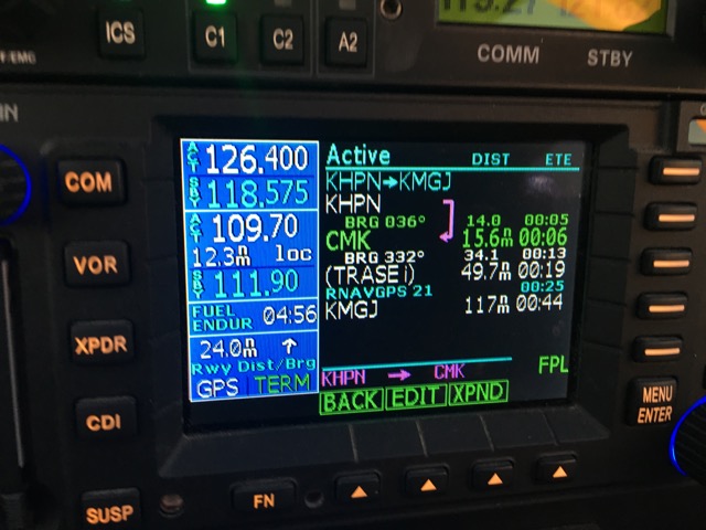

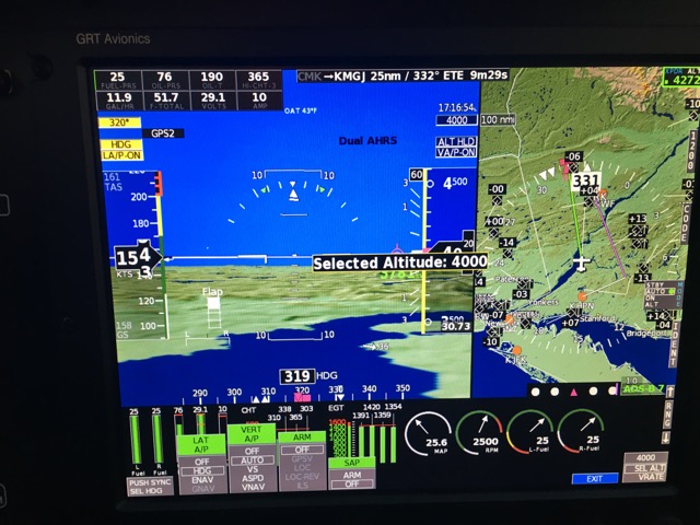

Ok. Tried again today.
Went out to airport. On the ground, Loaded a flight plan to MGJ into 480. Copied to GRT. Selected an approach on the 480, loaded (GPS 21) and "execute" (on 480). Went to GRT (still on ground) and all the menu choices were accessible (Arm, etc). I armed the approach and the "Execute" softkey appeared as it should. I shut down the master and took care of some other things. Went back to aircraft, got my clearance and departed. Once in the air, I actually changed approaches on the 480. Went to the GRT AP menus and everything is grayed out again.(Photo attached). I noticed that ENAV is available, but not GNAV. I was able to fly the approach on the AP, but not "armed" as an approach. It followed the imported FP (including the approach fixes) and I manually entered the altitudes, but it was never in "Approach Mode". Later, I was able to enter a synthetic approach to runway 11 @ HPN and I was able to Arm it and execute, but it never captured the gluideslope. I am stumped.
If you notice on the photo of the 480, I tried this enroute, before I was at the IAF (TRASE). I tried again after TRASE, but still no joy.
BTW the 480 is GPS 2. The First Photo is the screen when I was flying to TRASE. Note the AP indicators. No approach.
